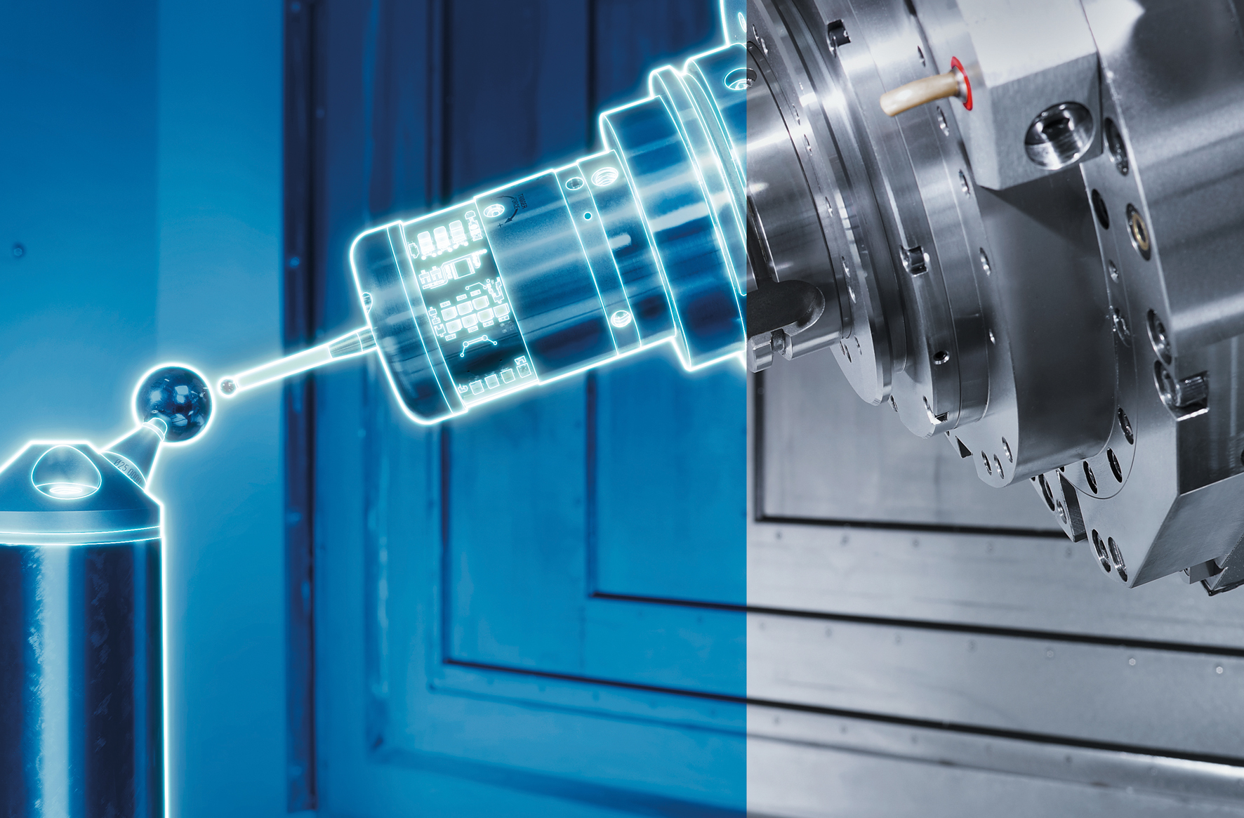

3D quickSET is one highlight in the field of measuring cycles: Tool kit for checking and correcting the kinematic accuracy of 4 and 5-axis machine configurations All head variants and table axes Note: In conjunction with the measuring probe option only
